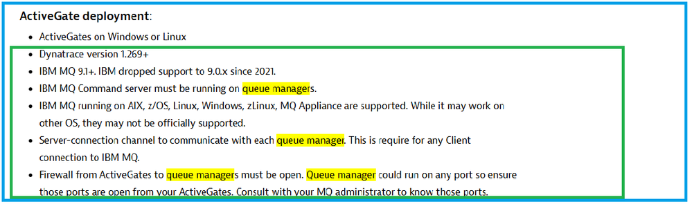

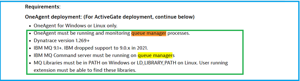

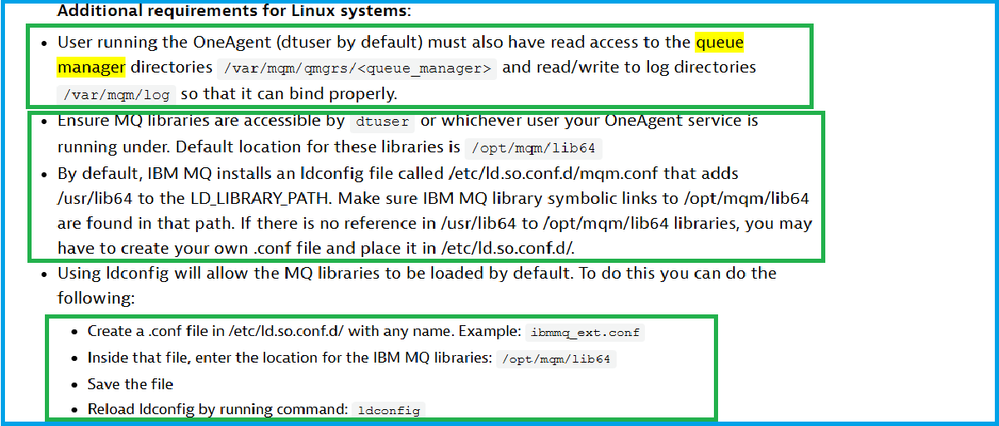

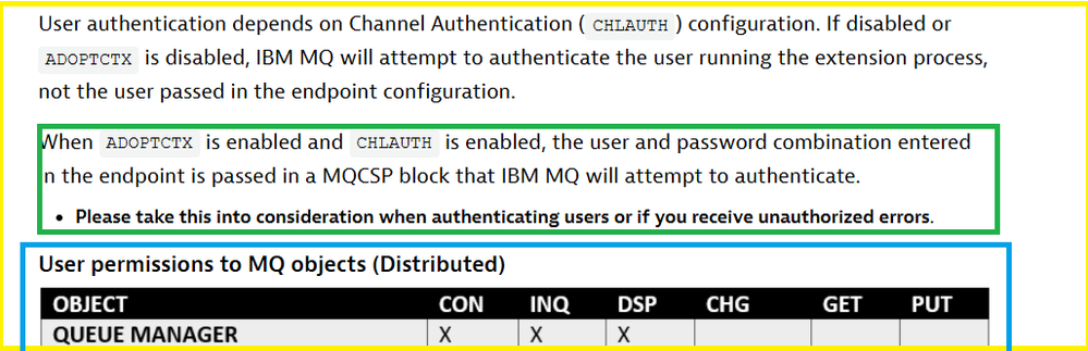

Hi @AK
For the Failover situation:
Validate against the current configurations if the below requirements are met or something is missing:
For Full information regarding the current situation, you can also validate against your current deployment model either it's through Local Oneagents deployments or Remotely:

Hi @AK
Appreciate your feedback, It's also best practice to ensure that you have 2 AGs deployed in the configured network zone to run the extensions or routing OA traffic, for ensuring the failover mechanism is achieved.
