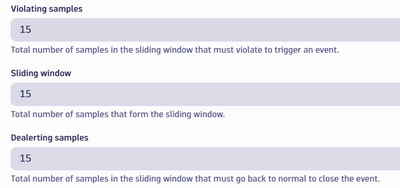

I have created a customized Davis Anormaly Detector , the status of the detector looks good, and from notebook metrics chart visualization, I believe there are a few potential alerts based on the threshold I set for this detector, however, there is no problem created. I have included the dt.source_entity as {dims:dt.entity.service} in the details of my detector.
Can someone help me understand what might be missing so the problems can not be created?

@zhengma Couple of things to check, first would be alert conditions, check the set threshold ,click on advance and see if the below are correctly set.
In the same section, click on Preview and check the status, do you see any potential alerts?

Thank you for the quick response! Yes I see the potential alerts of the detector I set up.
