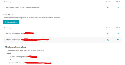

Welcome @Adi_10 ,
You can create an alerting profile with a configuration like this:
Hope it helps.

Hello Adi,
After following Elena's advice to create the alerting profile you need to go to: Settings > Integration > Problem notifications
Then select Pagerduty and fill in your configuration.
Then at the bottom select the alerting profile that Elena told you to create.
