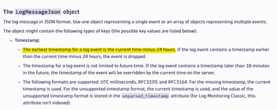

Regarding old time stamp, wonder if your ingest mechanism configure right to use the timestamp because of the 24 hours limitation on timestamp
HTH
