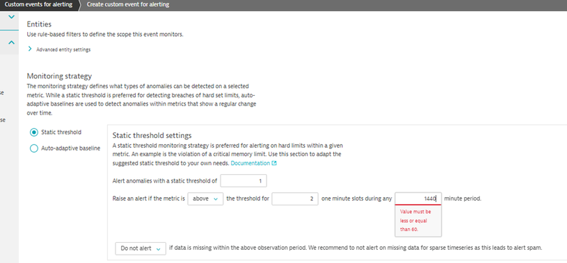

I would like to create a custom alert on log monitoring whereby an alert is raised when more than 1 log events occurred in a day. I tried to configure the custom event to raise an error when the metric threshold is above 1 in the given day, which is 1440 minutes. However, the maximum value of minutes period is 60. Can anyone advise me on this issue?

The requirement:
Raise an alert if the metric is above the static threshold of 1 in 2 one minute slot during a day (24 hrs)
The scenario:
Our client has a server that will restart once everyday, hence, one "initialized" keyword will be observed in the log. If there is more than 1 "initialized" keyword raised in a day, an alert should be raised so that our client can look into the issue.
May I know if there is any way to achieve the above requirement?
