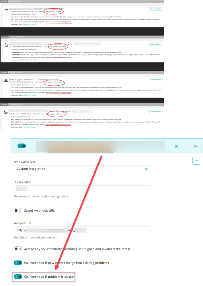

Hello, I have several cases in which we have enabled the option for Davis to notify us of issue closures in different integrations (in this case, a webhook), either manually or automatically.
As you can see in the attached image, Davis informs me that the alerts are delivered via alerting profiles.
My question is: Do I have any evidence elsewhere that Davis has actually sent the closure notification, either through the webhook call or by email, as the case may be?

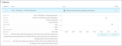

Maybe you can use "dsfm:server.notifications.problem_notifications" with useful dimensions:
Best regards
Thanks, I forgot about that, It will do the job.
