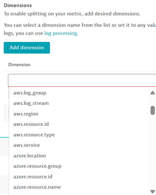

It depends on how you create the metric. You specified that you have a field called TotalFailures.hostname by which I assume you have processed the log and created this attribute.
You just have to add that as dimension when creating metric from the log. If you already have that attribute, you get that in this dropdown
Reference:
Then while creating metric event you can use that dimension as {dims:TotalFailures.hostname}
