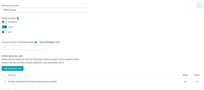

I configured the rule like this:
But it opens a problem where it says it can't find the process. What am i doing wrong?

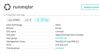

That process is already discovered at the host level, image:
Issue here is the port part. We want to monitor only the process running on 1416 and not the other.
I was trying to see if there was a way to monitor that specific process instead of de-aggregate the process group (Don't even know if it's possible to de-aggregate through port because of tecnology being classified as other).

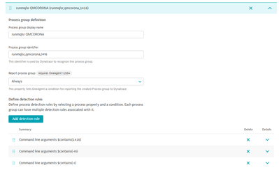

Maybe exe path contains more information where you can define your own Process group detection.
And later, when process is split out, you can enable alerting.

Hi everyone. I got it.

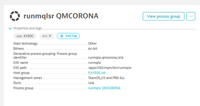

So the process is splitted. Didn't need to configure it at the environment level but at the host level. Inside Host -> Declarative Process Grouping, the following configuration:
It's solved. It would still be good to find out how Host -> Process Availability works and if it would be possible through that setting, but either way this is a good solution. Thanks.
