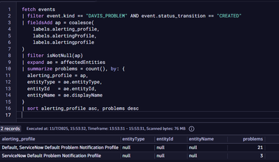

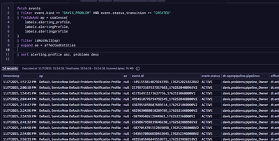

Here’s how I approached it.
I checked which fields are available on DAVIS_PROBLEM events to see how I could link problems to an alerting profile and the impacted entities:
fetch events
| filter event.kind == "DAVIS_PROBLEM"
| limit 1From this inspection I noticed the label labels.alerting_profile.
So as @michiel_otten and @p_devulapalli wrote, I mapping alerting profile with entities and counted problems:
fetch events
| filter event.kind == "DAVIS_PROBLEM" AND event.status_transition == "CREATED"
| fieldsAdd ap = coalesce(
labels.alerting_profile,
labels.alertingProfile,
labels.alertingprofile
| filter isNotNull(ap)
| expand ae = affectedEntities
| summarize problems = count(), by: {
alerting_profile = ap,
entityType = ae.entityType,
entityId = ae.entityId,
entityName = ae.displayName
| sort alerting_profile asc, problems descIf you don’t want the results aggregated, just remove the summarize step and keep the expanded rows.
