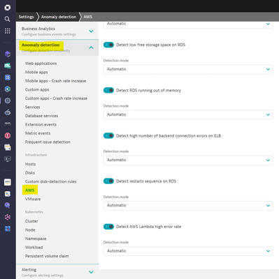

1. Without knowing what is important to you/your team this is difficult to answer. One team might care about network metrics, another about hardware, another about users. Also with over 100s of metrics to pick from relating to many different services (like 80+ supported) there is a lot. However, to get an idea of things that are important, Dynatrace has OOTB alerting available. This is only for a very small few services and metrics but it is there and can give you ideas. You can also look at other alerting options under the same settings to get an idea.

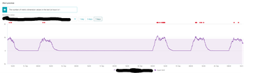

4. While setting up custom alerts you can see the last 7 days and whether or not those custom alerts would have alerted. This is incredibly helpful as well for setting up alerts just after a problem has occurred because you can tune the alert to not fire except during that problem scenario since you can visualize it right there in the UI.
