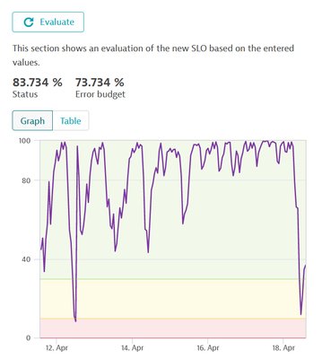

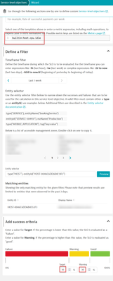

@RohanIt's not the ideal use of this, but you can try to define an SLO:
I've made an example for you, I choose CPU idle metric, you can filter the hosts by tag or entityID, and set the target to 10 and 30 (because you are using idle metric)
Then you can try it with evaluate:
I've never use this with this purpose, but it can work. Please let us know.
