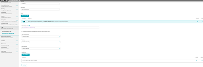

Hi @pvr ,
atm it is not possible to attach the value of a dimension to a generic type directly from the ingested log line. However you can extract the dimension value and add it as a metadata to the generic type like displayed in this example here
The attribute section is what you would be looking at
attributes:
  - pattern: '{network.name}'
    key: wmi_network_name
    displayName: Name
  - pattern: '{network.type}'
    key: wmi_network_type
    displayName: Type
