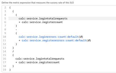

I’m trying to define a combined, traffic-based availability SLO in Dynatrace, built from multiple calculated service metrics (for example, total requests vs. failed requests across several endpoints).
The basic success formula is the usual one:
success = 100 * (total_requests - failed_requests) / total_requests
This works correctly as long as there is traffic.
However, I’m struggling with the edge case where total_requests = 0, which can legitimately happen (for example during maintenance windows, upgrades, or when the service is intentionally unavailable and receives no traffic).
Observations so far
  • default(0) works as expected for error metrics (failed request count).
  • Applying default() or value to total request metrics either:
    • is rejected by the metric selector (for example ...total...Requests:count:default(0)), or
    • produces syntactically valid expressions but leads to unexpected SLO values and burn rates (for example ...total...Requests:value:default(0)).
    From a pure math perspective, this does not necessarily imply a division-by-zero problem — the numerator would also be 0, and the denominator can even be guarded with a non-zero default (for example default(1)) to keep the formula mathematically valid.
  • When total requests are zero, the SLO evaluation either becomes N/A or produces non-intuitive results if workarounds are attempted (for example very low percentages like 4%).
Example expression
This expression works correctly as long as total requests are greater than zero:
100 *
      calc:service.totalService1Requests
      + calc:service.service2Requests
      calc:service.errorService1Requests:count:default(0)
      + calc:service.errorService2Requests:count:default(0)
    + calc:service.totalService2Requests
Questions
  1. Is it by design that traffic-based SLOs in Dynatrace cannot meaningfully evaluate to 100% when total_requests = 0?
  2. Is there any recommended pattern to handle this case within a single combined SLO (for example, treating “no traffic” as healthy)?
I’d like to avoid workarounds that distort the SLO math or burn-rate calculation, and instead understand the officially supported behavior and best practices.
Regards, Deni
Dynatrace Integration Engineer at CodeAttest

@deni  can you be more specific with the errors and results you have? (screenshots please).
I believe that this is caused by the way how (classic) SLOs are calculated - the SLO uses inf resolution. This essentially breaks metric expressions as there are single values used instead of timeseries as input for the expression. In other words - a division of averages is not the same as the average of divisions.
You can see that, for example, in the playground, I took a "zero" only metric - as an example
But your case can be different. Also worth mentioning:
  • You miss splitby in the metric selectors in the expression. this can produce unexpected results. use splitby, ideally removing all dimensions if it suits your case - e.g. :splitby()
  • There is a success rate metric builtin:service.successes.server.rate and also success count metrics
  • Generally, if there is no value, you can't measure. If there is zero traffic, you can't say your success rate is 100% - as there was no success.

The setup is intentionally simple: I’m using a small demo application that I wrote only to reproduce a real customer scenario.

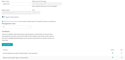

I’ve defined calculated service metrics for:
  • total request count
  • failed request count
This setup exists for two endpoints:
  • login
  • register
In total, there are four metrics (2× total, 2× failed), which are combined into a single, traffic-based SLO.
There is no business use case behind this setup — the goal is only to reproduce and validate the customer’s real production behavior with minimal endpoints.
To generate traffic, I run a script that sends requests for a short period of time.
Once the script finishes, traffic stops completely.
On the customer side, this situation can legitimately happen as well (for example during maintenance windows or upgrades).
Currently:
  • There are no failed requests (error generation is not yet part of the test).
  • Example data looks like:
    • 20 total - 0 failed / 20 total
    • later: 0 total - 0 failed / 0 total when traffic stops
The SLO expression compiles successfully

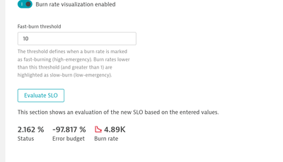

but when I press “Evaluate SLO”, the evaluation shows this - I don't understand where these % comes from.

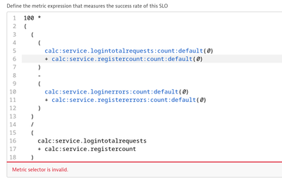

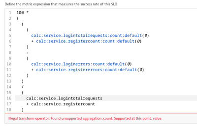

If I try to apply a default() to the total request metrics, for example:
or
I don't know why the error is different even that the code is the same - sometimes I see the first error and sometimes the second one.

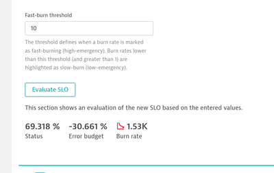

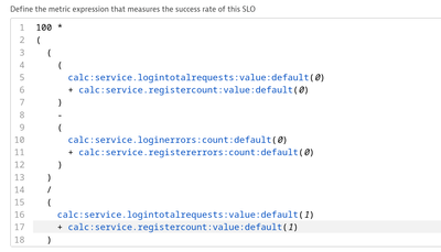

 I can write it like this:
but when I press “Evaluate SLO”, the evaluation shows this - Again, I don't understand where these % comes from.
Regards, Deni
@deni as I wrote before - add :splitBy() and :auto  tranformations. Also add the :fold(avg) (see my example above).
Always model this in Data Explorer first (easier) and use single value (don't change the fold aggreation in the chart options).
