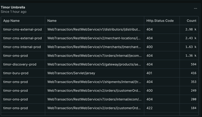

Additionally, could you please suggest how we can retrieve requests/API details for a workload?
Currently, we can get key request endpoints, but we are looking for a way to include:
  • Workload
  • API/Request name
  • Status code
  • Request count
Any guidance on achieving this would be greatly appreciated.

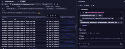

One way to achieve this is you use the field 'endpoint.name', but the API/Request must be set as Key Requests, otherwise, you will get the value as 'NON_KEY_REQUESTS'.
Other way to achieve this is using the spans (fetch spans), but in my tests, I was not able to display the HTTP status code, and also, the spans data may be sampled and not the 100% of your transactions.
