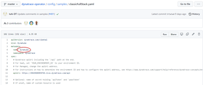

Hi, I have recently deployed Dynatrace on one of my Non-prod GKE cluster to get better visibility and monitoring. I followed the steps listed here https://www.dynatrace.com/support/help/shortlink/full-stack-dto-k8#manual , used the recommended configuration approach which is classicFullStack. I downloaded the file from here as mentioned and customised as per our requirement.
Also We used pipeline to run these commands.

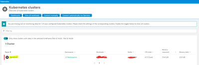

Now everything worked fine and I am also seeing data in Dynatrace but I have a question about the Cluster name which is auto generated I guess from the Custom resource file. The name is 'dynakube'. I am trying to understand where that name is coming from? And is it possible to modify because when I deploy this to Production, what name would it pick?
It looks like this at the moment and this is everything for my Non-prod cluster. What happens when I deploy this to Prod or any other cluster? How would i differentiate?

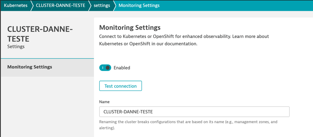

You can edit the name after deploy, on the Settings page for the Cluster.
And/or During the deploy, you may try the param together with the final kubectl apply
--cluster-name "MyClusterName"

When you manually add a cluster the name of the cluster is defined in the yaml file
You can always change the cluster name in Dynatrace by going to the cluster settings (click on the 3 dots on the cluster line under the Kubernetes section)
Hope this helps

'dynakube' reference is also made in kubernetes.yaml file so I guess we would need to change that as well.?

You can add the name metadata as pointed by @lplichart .
And I am not 100% sure, but you can also include the "--cluster-name "MyClusterName"" during the apply to name your cluster on Dynatrace.
