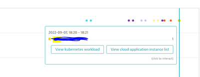

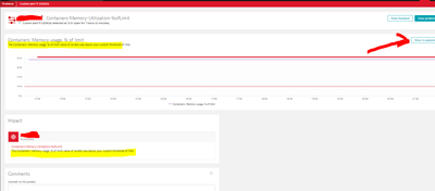

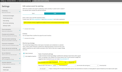

I have created Custom Alert for container CPU and memory utilization in % of the limit.
It has triggered problems but in Problem details there is no container/containerGroup name printed,
please let me know whether its possible to print container/containerGroup name in Problems.
Or let me know if there is totally different approach to achieve this.
select "show Explorer" to show containers breaching threshold.

Hi Chris- thanks for reply.
{entityname} -> entityname giving Env name here not container/containerGroup name.
The {metricname} value of {severity} was {alert_condition} your custom threshold of {threshold} on {entityname}

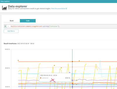

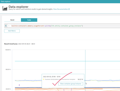

Hi 👋,

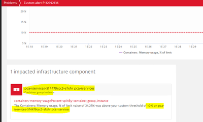

you need to use the "container-group-instance" for splitting. The "Container" is only the name, so it doesn't link to an entity. The container-group-instance is the unique identifier for your container and is thus linked to an entity.
builtin:containers.memory.usagePercent:splitBy("dt.entity.container_group_instance")
Using a valid entity for splitting will result in the proper link in your problem card 🙂
You can always use our data-explorer for testing these links by hovering over some lines.

05 Sep 2022 08:50 AM
Hi Florian,
thanks for reply.
The approach suggested by you looks good, its showing container-group-instance in the problems.
builtin:containers.memory.usagePercent:splitBy("dt.entity.container_group_instance").

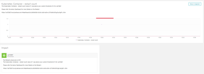

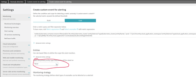

Hi ,

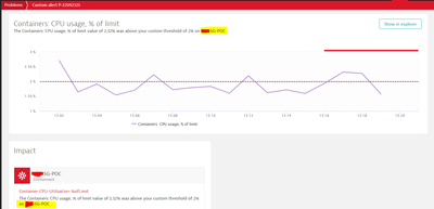

Please find below the screenshot for one of the sample fired alerts , the problem is attaching itself to the Environment , in my case my Env ID is val72867
Below is my Alert configuration :

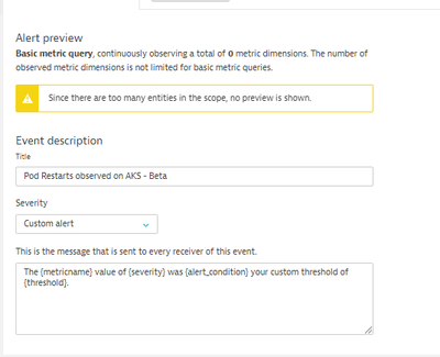

also the "The number of metric dimensions in the last 24 hours exceeds the limit of 1,000. Please refine the entity scope or the dimension filters above or choose a different monitoring strategy" error is something I am seeing only today
08 Sep 2022 11:55 AM

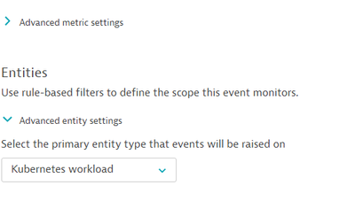

thx - the dimension error is a limitation, meaning there are too many entities in scope of the given filter. can you please also share the upper part of your config?
08 Sep 2022 12:21 PM
Thanks , Pls find below the requested information
08 Sep 2022 02:06 PM

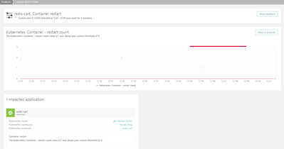

looks like your primary entity is wrong - please try "None" or "Kubernetes workload" in there. this should fix your issue.
08 Sep 2022 03:35 PM
Thanks a ton , I have changed my alert type to Kubernetes workload to if it helps . Will cross check as soon as another alert fires .
Is there some recommendation to get around the "the dimension error is a limitation," issue ? Will this prevent us from getting alerted if there is a issue ? Also please do share any recommendation to avoid such in this case . Below is the query I use .
builtin:kubernetes.container.restarts:filter(and(in("dt.entity.kubernetes_cluster",entitySelector("type(kubernetes_cluster),entityName(~"prod~")")),in("dt.entity.cloud_application_namespace",entitySelector("type(cloud_application_namespace),entityName(~"agys~")")))):splitBy("dt.entity.cloud_application"):sort(value(auto,descending)):limit(100)
Should i avoid using some filters maybe ? I for sure need the namespace filter , but if it helps I can try avoiding the clustername filter .
08 Sep 2022 04:38 PM
Just would like to pass the Thanks to @florian_g , The primary entity type change works great and I see the problem now linking to the correct workload 🙂

as you said, the limitation makes your alert unreliable. Basically, the problem is, that there's simply too much data per minute to keep track off. So actually narrowing down the scope of your alert (that is, adding filters), might help you to solve this. From what I know, there's one limit per alert and one limit for your entire environemnt. Meaning, that you won't be able to simply narrow down the scope of your alert and afterward create an endless number of alerts to cover all the other areas. At some point this limit is likely going to hit you. So that's likely not what you wanted to hear - so let's turn to the good news.

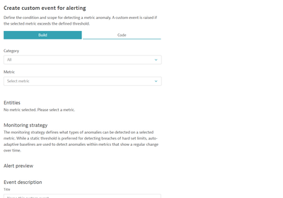

just realized another very important thing @hari-m94 - your use-case only involves one metric. For such use-cases, I always recommend sticking with the "build" mode - this one comes without the mentioned limitations 🚀 See below how this could look like for your use-case - works perfectly in my environment.

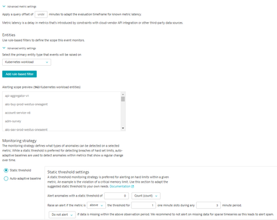

20 Sep 2022 10:47 AM
Hi @florian_g ,
Unfortunately the builder way of adding the alerts is not working as all and I am seeing no alerts getting fired . Unsure if I am missing something . Please take a look and advise (I have added the alert screenshots below for you quick reference)
30 Sep 2022 12:45 PM
looks valid - only thing I notice: the query offset says "undefined" (second screenshot on top). Could you set this to the default of 2 pls?
If this does not help, please open up a support ticket as then I would want to have my support/engineering friends to have a look at it.
