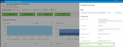

I deployed Dynatrace on AKS cluster with host monitoring mode in order to cover infrastructure monitoring on cluster nodes :
https://www.dynatrace.com/support/help/shortlink/dto-deploy-options-k8s#host
My dynakube ressource is based on template hostMonitoring.yaml :
https://github.com/Dynatrace/dynatrace-operator/blob/v0.11.0/assets/samples/hostMonitoring.yaml
But Oneagent nodes appear in full stack mode instead of infra_only on Dynatrace and the consumption of host units is like a full stack mode :
Do you think it's a abnormal behaviour or it's a specificity of kubernetes instrumentation ?
Thank you.
