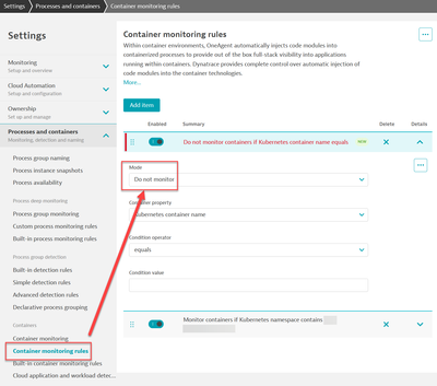

DanielS
Hello @henk_stobbe Could you please check if you have something of the type DO NOT MONITOR configured here:
regarding NGINX pods?

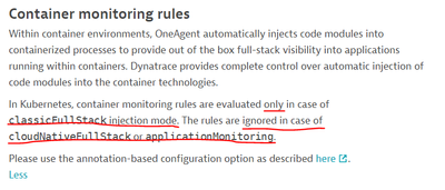

Hi @henk_stobbe
I confirm you that Container Monitoring Rules disable processes injection as Daniel says. We've configured some rules here and it's disabled the deep monitoring in the processes running in the namespaces that match with the rules.
But in our case, Kubernetes is on cloudNativeFullStack and it shouldn´t apply the rules:
But it's doing it!
We changed the deployment mode from classicfullstack to cloudnativefullstack.
Maybe this is reason for which the rules continue applying. Does anyone know if this may be the reason?
Regards,
Elena.

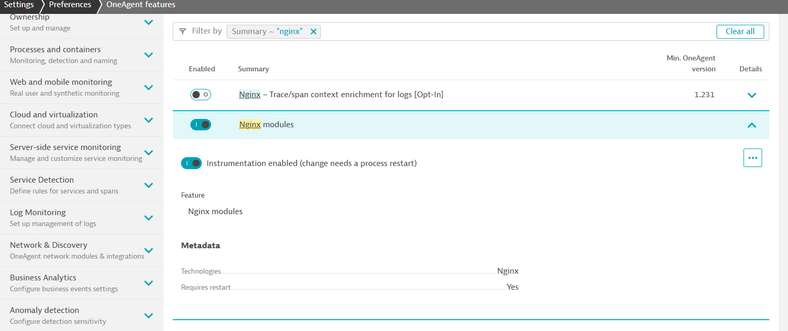

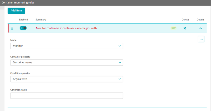

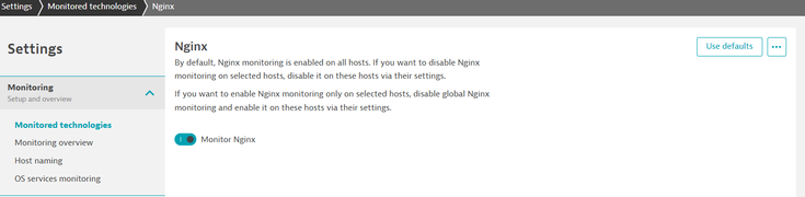

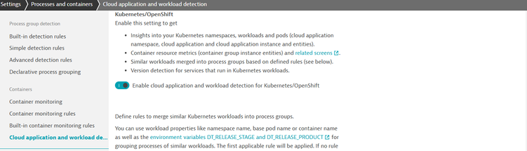

Hello @henk_stobbe
Kindly,
first check on the environment level
container monitoring level
ensure cloud application and workload detection is enabled for K8s
ensure onaagent services are configured and Restart is executed
try adding container monitoring rule
update operator version, restart and validate the Process technology is supported or not
https://docs.dynatrace.com/docs/shortlink/section-technology-support#nginx
Thanks.

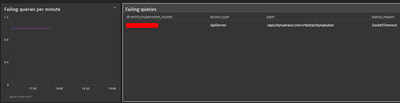

After trying everything in this thread, we were able to get it to work.
We are using GKE, and after reviewing the following link:
We identified that the Kubernetes API was the issue. We followed these steps:
- Check the control panel IP:
We used the following command to retrieve the Kubernetes control plane information:
kubectl cluster-info
- The result was:
Kubernetes control plane is running at https://192.168.0.0
- Update Firewall Ingress Rules:
We then added this IP to the ingress rules in the firewall using the following command:
gcloud compute firewall-rules create allow-webhook-api-server \
    --direction=INGRESS \
    --action=ALLOW \
    --rules=tcp:8443,8383,100200,8443 \
    --source-ranges=192.168.0.0/8
Service Restart:
After adding the rules, the webhook service started working again. After rebooting the services, everything resumed functioning properly.
