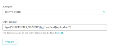

We use this in entitySelector string in management zone creation.
Like
Same goes with tags as well. We use a entity Selector query for that one too. Once you have added the tags from Auto-Tagging rule (Again need to use entity Selector query here).
We can use the entity selector query like this
Let me know if it worked.
Thanks 😄

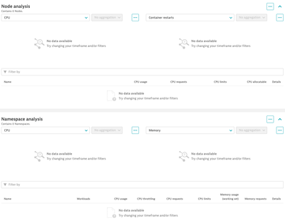

Thank you!! That did work for MZ on the AKS cluster, but metrics does not appear when I click the cluster. I used the first option with entityid of the cluster for creating management zone

Hi
Yes, I can see the metrics without the MZ. The access seems to be fine. We tried adding another namespace and node filter with that entity id and the namespaces node metrics showed up in the management zone,  but still dont see pods, pod metrics, etc. Adding these entityid based rules for all would be cumbersome and still would not show all the data in MZ.
