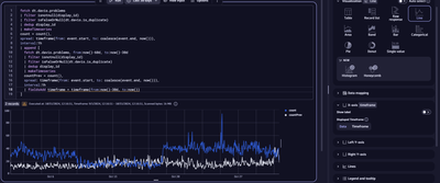

Hey @wmisenhe
You can append a new query of the same data but with a different timeframe. Then within that appended query you can override the timeframe to be the one from the original query. This will allow you to layer 2 timeseries of different timeframes on top of each other. The last thing to do is to change the graph settings to use the timeframes from the data and not the queries as seen below.

| append [
  fetch dt.davis.problems, from:now()-60d, to:now()-30d
  | filter isnotnull(display_id)
  | filter isFalseOrNull(dt.davis.is_duplicate)
  | dedup display_id
  | makeTimeseries
  countPrev = count(),
  spread: timeframe(from: event.start, to: coalesce(event.end, now())),
  interval:1h
  | fieldsAdd timeframe = timeframe(from:now()-30d, to:now())
 Hope this helps!
