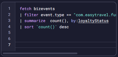

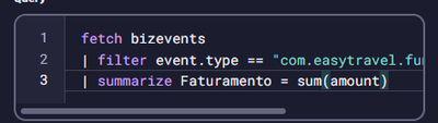

1. Is it possible to change the column name? Maybe it's possible to add a title to the table?
2. Is it possible to change the display to total in dollars?

you can use alias like this
fetch logs
| fieldsRename severity=loglevel, source=log.source, logmessage = content
Here the documentation page
https://www.dynatrace.com/support/help/shortlink/dql-commands#fieldsRename
feel free to ask if you have any doubts
It worked out! Thank you very much!
Do you know anything about inserting a title for the table to be displayed on the dashboard? I'm still unsure about how to convert the amout value to money
