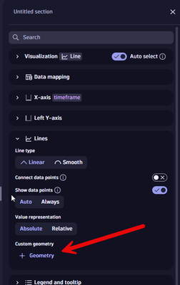

In above DQL, how can I have success and failure as bar charts overlayed on the line chart but the y axis has different values for bar chart ?

I haven't run your query, but I will assume that it outputs multiple timeseries that you wish to visualize in a single panel using different chart types. If that is true, then you may not need to change your query at all.
You can combine different chart types by using the custom geometry option within the visualization settings.
I hope that helps.
