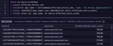

Here is a sample DQL
fetch dt.davis.problems
| expand affected_entity_ids
| fieldsAdd app.name = entityName(affected_entity_ids, type: "dt.entity.application")
| filter isNotNull(app.name) and isNotNull(dt.davis.affected_users_count)
| fields event.id, app.name, dt.davis.affected_users_count
