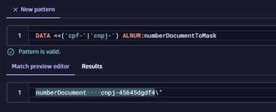

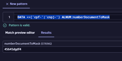

Hi @RPbiaggio,
I reviewed your question and I believe the following DPL pattern might work for you:
DATA <<('cpf-'|'cnpj-') ALNUM:numberDocumentToMask
This pattern captures the alphanumeric values that come after "cpf-" or "cnpj-", which you can then mask with just "masked". As a result, you would get "cpf-masked" or "cnpj-masked". Please note that this only works if the value you want to mask starts with "cpf-" or "cnpj-".
I’m also attaching some images that show the pattern applied to a sample text for better clarity.
I’m not sure if this fully answers your question, but if you’d like to explore it further, feel free to reply to this message and we can look into it together.
Thanks!
