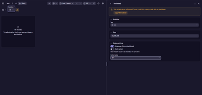

Hello community,
Could you please help me with this demo dashboard?: https://{environmentid}.apps.dynatrace.com/ui/apps/dynatrace.dashboards/dashboard/5c4c8356-8344-44e2...
We applied it in our environment some time ago, but recently these warnings started to appear. We need to adjust the DQL query for the dynamic variable auto_sampling_ratio so that the sampling ratio value is exactly 1, 10, 100, or 1000, since Dynatrace only supports those values.
Any guidance or examples on how to configure this properly would be greatly appreciated.

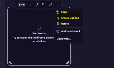

I don’t have this demo dashboard in my environment. However, to adjust the sampling ratio, you can add it as a parameter in the DQL query, for example:
fetch logs, samplingRatio:10
You can then adjust the ratio as needed. If the dashboard tiles are not currently DQL-based, there should be an option in the tile’s dropdown menu to convert it to a DQL tile.
Once converted, you can modify the sampling ratio parameter to eliminate the warning.

I also just saw that you are doing this through a variable. You can set the variable options to be 1, 10, 100, and 1000, and then set up a reasonable default value for the dropdown that makes sense for your dashboard.
Sorry for my initial confusion.
