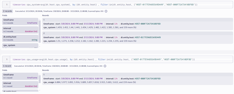

Before I attempt to explain, here are my test data. I will use 2 metrics for 2 hosts. First metric is available for both host while second only for one:

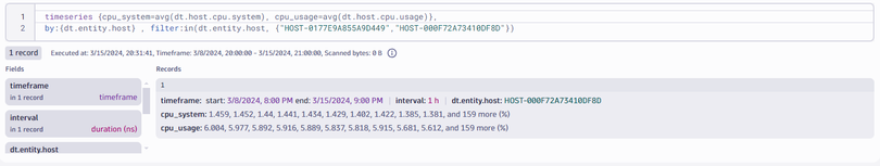

If I retrieve both metrics using single timeseries command, the result would look like:

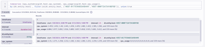

As you can see only one record with pair of metrics is returned for the host where both metrics are available. To have both metrics using such construct, I would use union:true option of timeseries command.

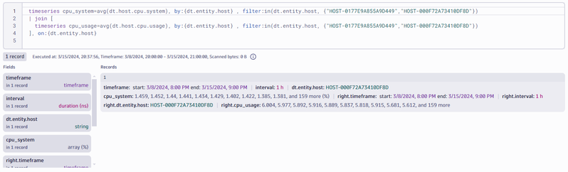

this option cases that records/rows when some metrics are missing are not eliminated. Here is how join command behaves with the same data:

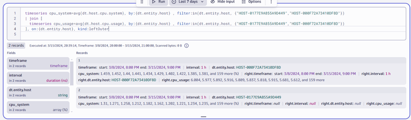

But join command offers also option kind:leftOuter which does not eliminate records returned by basic query where corresponding record from subquery is missing
Of course first query has to provide superset of what subquery returns.
