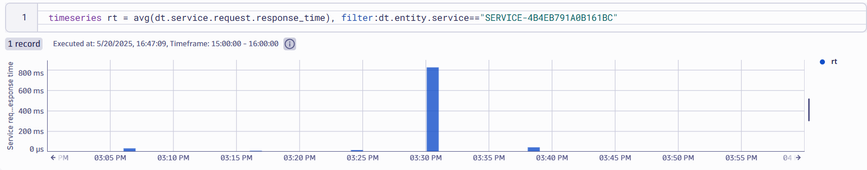

I have metric (response time for service) which behaves quite like in your description: sometimes we have measurement with major break in between.
Query to get the data looks like this:
timeseries rt = avg(dt.service.request.response_time), filter:dt.entity.service=="SERVICE-4B4EB791A0B161BC"The result looks like (one measurement over 0.8s, several below 50ms)

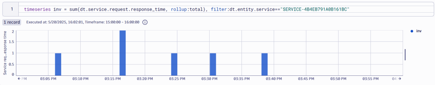

Apart of actual measurement (response time in this case), each timeseries keeps number of measurements/contributions to metric in specific time slot. To get this information use of rollup:total option is needed:
timeseries inv = sum(dt.service.request.response_time, rollup:total), filter:dt.entity.service=="SERVICE-4B4EB791A0B161BC"Now we can see number of measurements over time. Of course spaces between bars stay away from each other, but timeseries command has interval: option which allows to widen interval according to needs. In my example I widen interval from default 1 minute to 10 minutes:

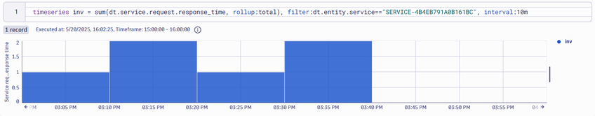

timeseries inv = sum(dt.service.request.response_time, rollup:total), filter:dt.entity.service=="SERVICE-4B4EB791A0B161BC", interval:10mNow bars are not longer apart:
I hope this helps.
