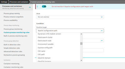

You can add a custom process rule to monitor using the EXE path like the below SC. this will separate the processes.

Both the processes that I want to separate have the same EXE path. The only difference being that they run on different ports. Is there a way to separate them?

I'm afraid the port is not an option.
Best option is using an ENV variable.
https://docs.dynatrace.com/docs/shortlink/process-groups#env
