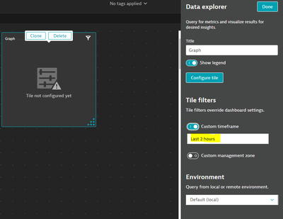

Hello @istvan_safranek ,
There is an option for that once you select the tile in edit mode, in data explore you have a custom timeframe, you can set time for the tile, based on your request.
Regards
Kaliprasad P

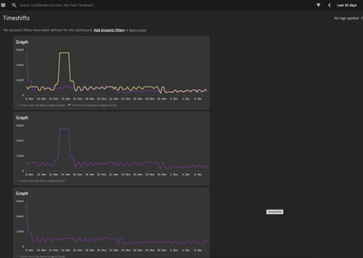

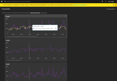

You can apply the timeshifts in the Data explorer itself using the code mode (see last illustration below how to do it) and it will then also take the selected timeframe on the dashboard into account like
Doc links:
https://www.dynatrace.com/support/help/shortlink/explorer-advanced-query-editor#example-compare-a-me...
https://www.dynatrace.com/support/help/shortlink/api-metrics-v2-selector#time-shift-transformation
Hope that helps.
Regards
Thomas

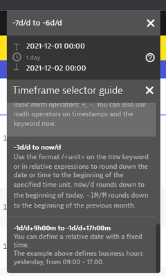

Hi @zietho
The only problem with your suggestion is that the shift is with in the time of the time picker which mean that if you want to show count for whole day yesterday , month ago and 3 month ago IMO it will not work.
What we done for this is to set the time picker in each tile for, today  , yesterday , 1 day 7 day ago (-7d/d to -6d/d), 1 day 30 day ago (-30d/d to -29d/d)
You can also adjust the start and end time in day as appears in the timeframe selector guide
HTH
Yos

zietho
Dynatrace Champion
Dynatrace Champion
Yes you are right but my answer was intentional to providing means to shift according to the selected timeframe.
So in essence there are two ways you can shift:
* static shifts according to the current time => select custom timeframe for a tile
* dynamic shifts according to the selected time frame => :timeshift transformation in the Data explorer
Hope that clarifies what you can do.
