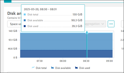

Anto, as i wrote in my initial post the number that is shown is wrong.
the disk.used is not the total of all disk used on a server. No idea of what it actualy is (i also asked that) but it looks like asking number of tires on the car, and the answer is 2. Yes there are 2 tires, but in total there are 5 (with the spare) but it's certainly not what the metric is giving me, so i tried to understand what is the metric actualy telling me.

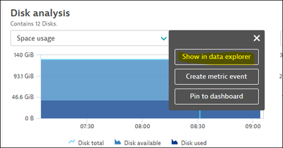

You have these disk metrics out of the box:
Make click in "Show in data explorer" and you can see which metrics and which filters they are using:
Best regards

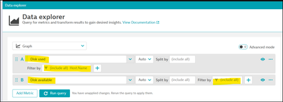

That one is from the server (as i also mentioned before)
It certainly not using "only" one disk.usag (as i also wrote before)

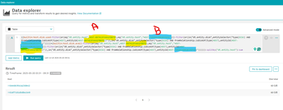

It uses the same "sum" and link that Muhammad showed. So yes in the data explorer on the server it works, i can send it to the dashboard. But contains the host id , 3 times for the B & C and 6 times for A. So maintaining it is ....

Muhammad. that certainly seems to give me the total of all the disk used, where would i add the filter for selectig only server A / B and D ?
Can you create a Management Zone for them, or you will add the hosts manually like below :
((builtin:host.disk.used:filter(or(eq("dt.entity.host",HOST-B97413FA4A1FBB7D),eq("dt.entity.host","HOST-F85861AD01B335FE"))):filter(or(in("dt.entity.disk",entitySelector("type(DISK) AND fromRelationship.isDiskOf(type(HOST),entityId(HOST-B97413FA4A1FBB7D))")),in("dt.entity.disk",entitySelector("type(DISK) AND fromRelationship.isDiskOf(type(HOST),entityId(HOST-F85861AD01B335FE))")))))+(builtin:host.disk.avail:filter(or(eq("dt.entity.host",HOST-B97413FA4A1FBB7D),eq("dt.entity.host","HOST-F85861AD01B335FE"))):filter(or(in("dt.entity.disk",entitySelector("type(DISK) AND fromRelationship.isDiskOf(type(HOST),entityId(HOST-B97413FA4A1FBB7D))")),in("dt.entity.disk",entitySelector("type(DISK) AND fromRelationship.isDiskOf(type(HOST),entityId(HOST-F85861AD01B335FE))")))))):splitBy("dt.entity.host"):sum
Try it and tell me if it works with you
Best Regards
Hi Muhammad, adding the servers into each of the sub settings is a terrible idea (in my head). If you want to add modify it you have to do it multiple places. If this how it must done in DT well no way around but dosent change the fact that it's terrible. Logic would say create a list of host that you want to work with, and then add the additional metrics you want.  Your example is the same as the data explorer shows for an individual server, where the server id is multiple times in the explorer. Not desired. HOST groups well would be a way to achive the same, by then using the host groups in stead of server names. But you still have that multiple times.
