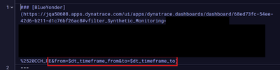

Hello Gerardo,
this is how you can pass timeframe from current dash you are visiting (main dash) to next dash (secondary dash) you'll visit.
In markdown tile after simbol # in the dash url add the following string:
from=$dt_timeframe_from&to=$dt_timeframe_to
at the end of the url instead add the following string:
&from=$dt_timeframe_from&to=$dt_timeframe_t
o
Example
Begging of URL
End of Url
good luck!
Yann
