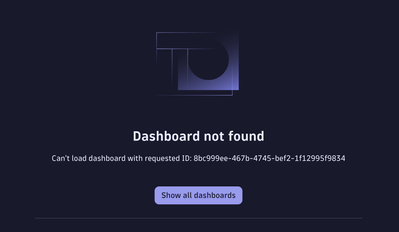

It would seem that whenever you create or copy a v3 dashboard from another tenant, it gets assigned a random id.
This makes it very difficult to create a dashboard with links to another dashboard in one tenant, and then copy it to another
I have this use case
In our Dynatrace setup we have 3 tenants for 3 environments.
in our Test environment we build v3 Dashboards to be copied to Validation and Production
Those dashboards contain links to other dashboards
We use monaco (or download + upload) to copy from Test to Validation
In validation the relative links are now broken as the copied dashboards get assigned a different Id
Is there any way to prevent the links from breaking
