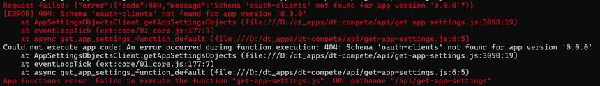

1st) the issue that I've tried to retrieve app settings through useAppSettingsV2 and get the below Error
2nd) as a workaround I've tried using settings client "appSettingsObjectsClient.getAppSettingsObjects" to be called within App Function and got the following error "'oauth-clients' not found for app version '0.0.0'":

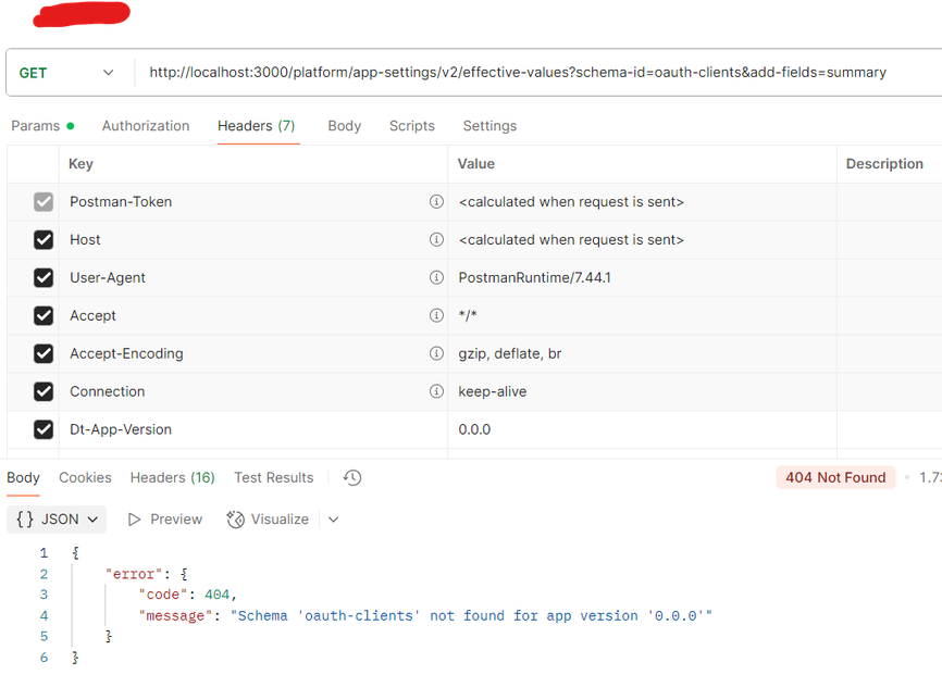

3) Finally, I've tried to access it the platform service API "http://localhost:3000/platform/app-settings/v2/effective-values?schema-id=oauth-clients&add-fields=s... with adding "Dt-App-Version" as shown in the previous error and got the same error.

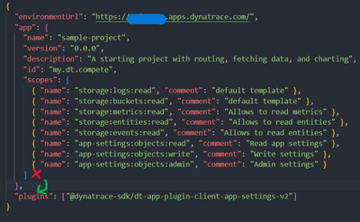

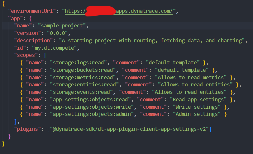

this is the app.config.json

plugin item was listed under app, I've moved it to be under the root object 🤔😲🤗 then all things has worked!!
