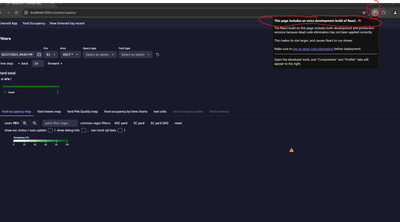

2 days ago I've updated to the latest version with
npx dt-app@latest update - got updated to 0.132.1
Since then, I can't debug my custom react dt-app in chrome, edge. It seems that either starting with npm start, or npx dt-app dev, it starts the app in production mode. (see screenshot attached).
When reverting back to 0.130.5, it stats correctly in development mode both with npm start, npx dt-app dev
(How I reverted back? created a new blank dt-app project, then copied over to my project folder node_modules folder, package.json from the blank project)

Hi Zoltan,
The extension message looks all right. When you open the devTools in Chrome, do you see Components and Profiler tabs added?
I've tested with the latest version of dt-app, and both debugging and breakpoints work using Chrome & VSCode.

Hi Haris,
This time it was my bad, had a messed up node env with all the different node versions I've tried.
Yes, I can confirm it's been resolved, react starts in development mode, and my breakpoints are registered.
Zoltan
Participant
One thing that caught my eyes is in the console, it's still saying React is running in production mode
It doesn't bother me as long as debug breakpoints are working, nevertheless I'm sharing this info here

It seems like you have both the prod and dev stages running there and some dead code files. Can you check if that's the issue since I can't replicate this myself unless I get your repo 🙂
