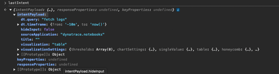

This was passed when using 'Open Field With' from the legend of a bar chart on a dashboard. The timeframe on the dash was 'last 10 minutes'... apart from not being passed as a relative value, it kinda looks like 11 minutes to me.
Are you sure the time selector was set up as the last 10 minutes? Since the only way to get that kind of timeframe for me is to manually select that timeframe, otherwise object looks like this:

lastIntent seen by the app...

Hi Andy! Apologies for the late reply,
I've been taking a look at your situation and as you said, whenever you open an intent from a chart legend, the intent contains the timestamp instead of the relative time.
For example:
"timeframe": {
    "start": "2025-07-18T08:57:00.000000000+02:00",
    "end": "2025-07-18T09:28:00.000000000+02:00"
I've forwarded this concern internally and it's expected behavior since we assume that you want to do a snapshot of the data whenever you do that.

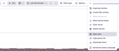

If you want to get the relative timeframe you can open an intent of the whole chart
Then, you will get the following timeframe
