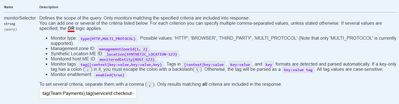

In the Dynatrace REST API reference it says
"To set several criteria, separate them with a comma (,). Only results matching all criteria are included in the response."

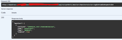

if i try to filter by tags i.e
tag(key1:value1,key2:value2)   it will return results matching ANY of the tags instead of only entities matching ALL
here is the uri : /api/v2/synthetic/monitors?monitorSelector=tag%28key1%3Avalue1%2Ckey2%3Avalue2%29%C2%A0%20
Am I doing something wrong? is there a toggle for only returning matching for ALL?

My mistake. The documentation is correct, but the key part is the definition of the word criteria.
type, enabled, managementZoneId, tag, and location are different criteria types.
The AND logic applies only when you combine different criteria types:
type(BROWSER),enabled(true)   → AND
managementZoneId(1),type(HTTP) → AND
However, multiple tag(...) selectors are not considered multiple criteria.
They are considered multiple values of the same criterion type.
Therefore:
tag(a),tag(b) is treated exactly the same as tag(a,b)→ both resolve to OR, not AND.
This is specific to the /api/v2/synthetic/monitors endpoint, which uses a simplified selector engine.
Other Dynatrace APIs (services, hosts, processes) support AND across multiple tag selectors, but Synthetic does not.

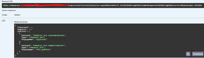

Since the monitorSelector in /api/v2/synthetic/monitors treats multiple tag(...) filters as OR (because they are values of the same criterion type), there is a reliable workaround if you really need proper AND logic across tags. Use entitySelector instead of monitorSelector.
Like this:
/api/v2/entities?entitySelector=type("SYNTHETIC_TEST"),tag("key1:value1"),tag("key2:value2")
This returns only the monitors that have ALL the tags, exactly as expected.
If key1:value1 is on many monitors, and key2:value2 is on only one of them
I tested it:

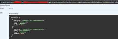

here i use 3 tags:

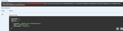

And here I use 2 tags as filter:
And now you can write simple script that retrieves only the Synthetic Monitors that match ALL required tags
