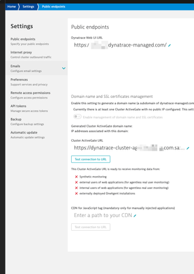

@Julius_Loman Thanks  for your response. When I tested the connection I am getting somethng like this.  What cross sign inidcates?
It performs some tests, from the mission control as well as internally from the cluster if the endpoints are accessible.
Be sure to check if the address https://dynatrace-cluster-ag.....com.sk:9999/rest/health is accessible from your mobile device.

You need to update the URL for Cluster ActiveGate in the CMC. (see my screenshot above)
AG url is with 443 only in cmc.
What exactly do you have in the cluster activegate url?
