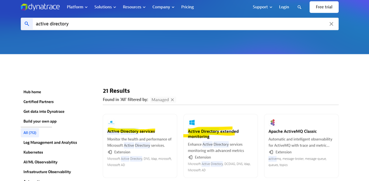

Dynatrace offers "2" levels of AD monitoring through the extension:
  1. Active Directory services as the name suggests "the foundational level"
  2. Active Directory extended monitoring. "Comprehensive view for AD Services"

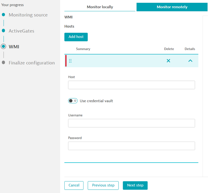

Remote monitoring:
  • ensure the AGs are able to reach AD Servers through telnet on port 443.
  • add the AD servers manually, then selected the required metrics sets.
  • save changes.
