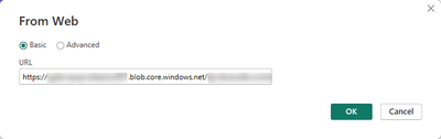

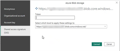

  3. User pulls JSON docs from Azure Blob Storage with SAS token via PowerBI to view cost data
    1. When you go to map the first doc's URL it will ask you for the SAS token that will be utilized. This token will be used for the rest of the files in the same blob container:

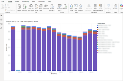

    2. Once data is being ingested, finance team members can use this to make custom graphs and queries like the one shown below:
