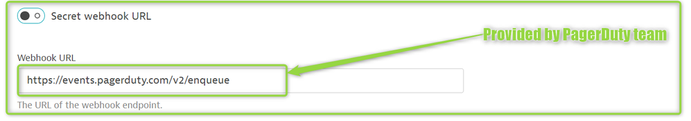

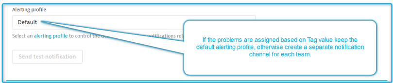

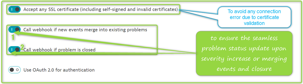

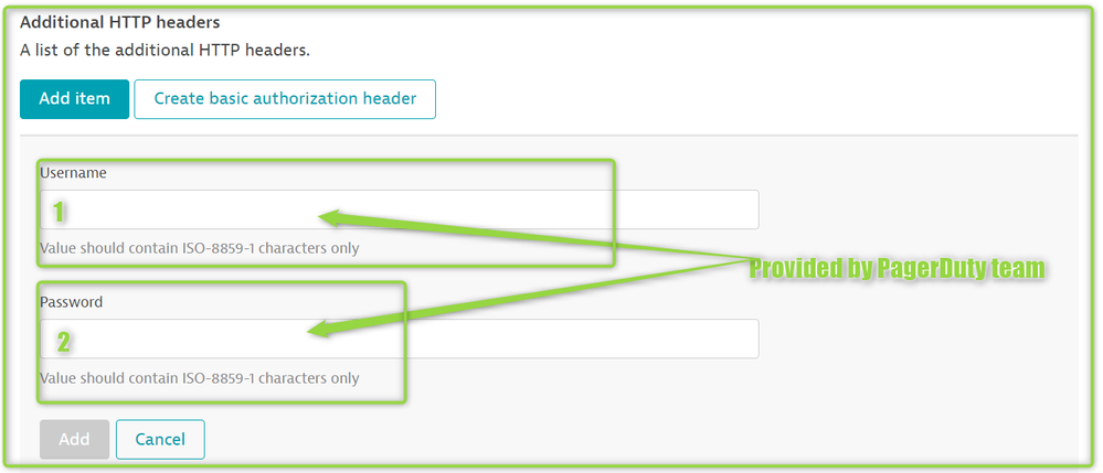

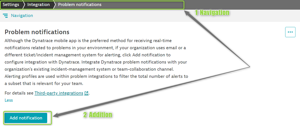

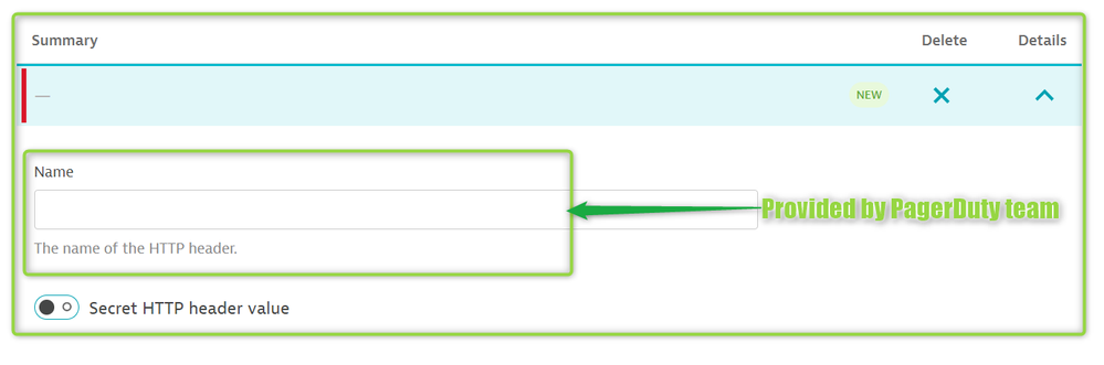

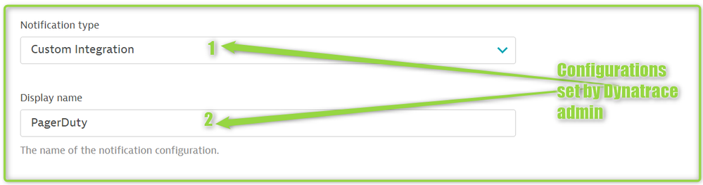

The attached procedures describe custom integration between Dynatrace and PagerDuty for app owners notifications.
Requirements:
  1. Connectivity between Dynatrace and PagerDuty.

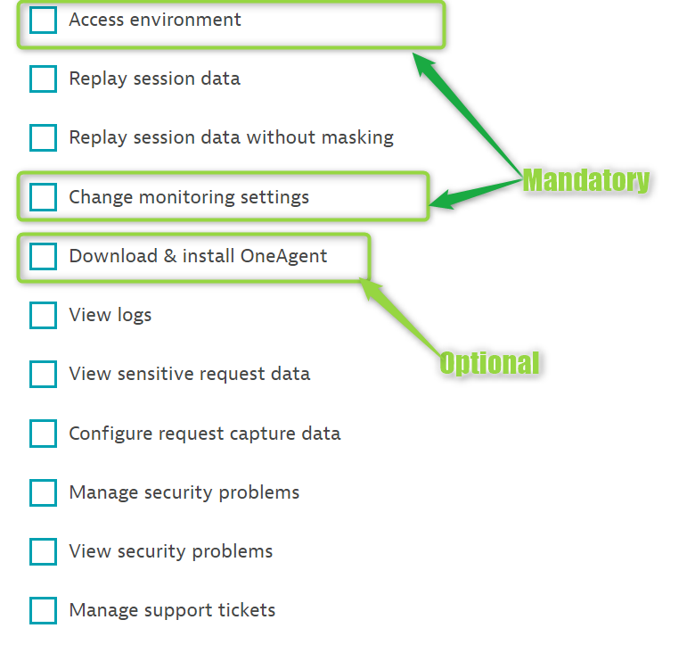

  2. On the environment level the implementer at least Have access environment and Change monitoring settings.
  3. Based on the RBAC policy you may configure manage security problems unless otherwise it's concerned with other team.
Hint
  • This method is used as the custom payload can't be configured or passed through the OOB integration.
Based on the actual setup you can specify the below parameters if exist
