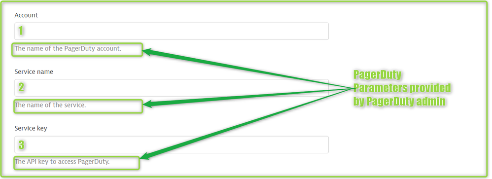

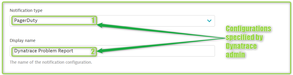

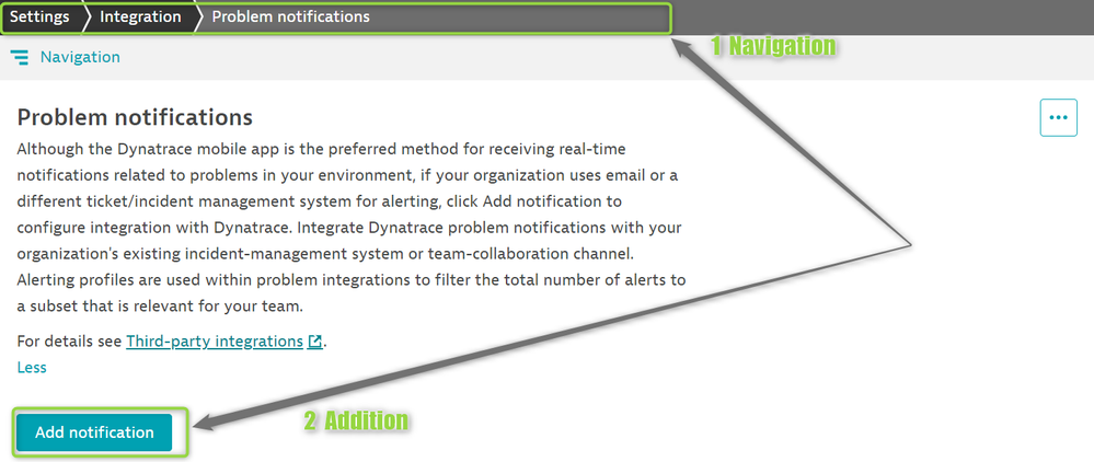

The attached procedures describe how to integrate Dynatrace and PagerDuty for app owners notifications.
Requirements:
  1. Connectivity between Dynatrace and PagerDuty.

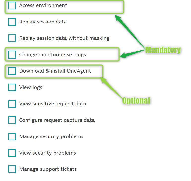

  2. On the environment level the implementer at least Have access environment and Change monitoring settings.
  3. Based on the RBAC policy you may configure manage security problems unless otherwise it's concerned with other team.
Hints
  1. As per the Out-of-the box integration you can't customize the sent payload to PagerDuty.
  2. For Custom Payload specification via Dynatrace, create a custom integration and specify the PagerDuty configuration parameters and the tailored custom payload as per monitoring requirements.
  3. A PagerDuty Integration Key is unique and associated with a PagerDuty Service defined in the PagerDuty service directory, which in case you need to create multiple integration channels with PagerDuty you will create multiple Integration keys.
