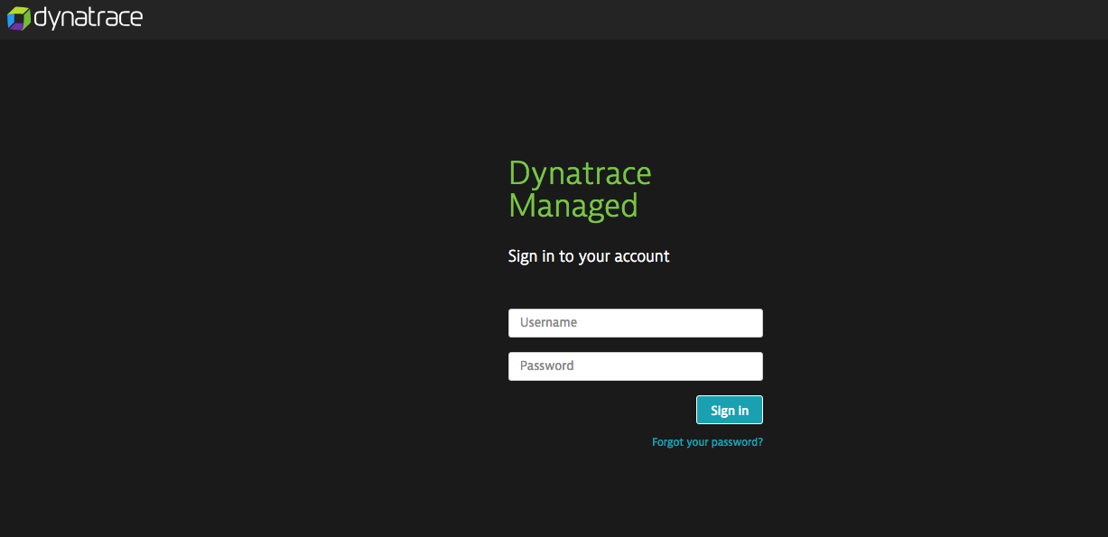

02 Jul 2025 01:38 PM
The forgot password link had stated that a password reset email has been sent:
But there is no email received. Do you know how to reset password via backend?
Thanks
02 Jul 2025 02:33 PM
Check the server log files for any errors related to sending emails. Or reach out to DT ONE using a support ticket, AFIAK they can reset it (but I never tried that). Do you have any other users with cluster admin permissions?
