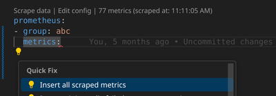

Extensions 2.0 must have metrics defined explicitly. Use the VS Code extension where you have development assistance which allows you to add the metrics automatically:
Please follow the lightbulb icon for assistance.
