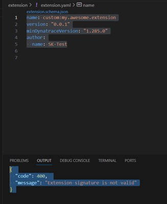

Custom Extension 2.0 sql query extension- Extension Signature is not valid
susmita_k
Organizer
We are trying to follow this documentation
https://developer.dynatrace.com/extensions-v2/dynatrace-extensions-vscode/guides/getting-started/?_g...
and upload this extension as a starting point, but we are seeing this error. any pointer is very helpful. Thank you
6 REPLIES 6
JamesKitson
Dynatrace Guru
Dynatrace Guru
That error when trying to upload a signed extension to your environment would indicate that the certificate used when signing that built extension doesn't match a CA/root certificate in the credential vault.
This step in the guide in particular.
Since this step involves popups in the lower right that you need to click in it's likely that when generating your certificates this step to upload the certificate to the environment was skipped so I would try and redo that step of generating certificates making sure it gets uploaded successfully (e.g. no permission errors etc...)
You can also check the credential vault manually to see if your expected root certificate generated by the Add On is there.

I solve the error message by regenerating new certificates from vscode.
