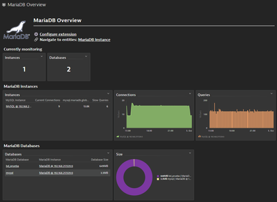

Disclaimer & Introduction
This document outlines the configuration for a custom MariaDB extension. Please note the following:
This extension was developed as a proof-of-concept for MariaDB monitoring, specifically because the existing official Dynatrace extension for MySQL did not fully meet the requirements or function as expected with MariaDB in our testing environment. The development involved adapting queries from the current MySQL extension to be compatible with MariaDB. Some queries were modified where the originals did not yield the necessary information from MariaDB.
Consider this extension to be in a beta phase. While it has been tested and is functional, it may not encompass all scenarios or have the same level of polish as an officially released product.

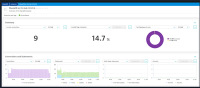

MariaDB Configuration for Dynatrace Extension
To ensure the proper functioning and comprehensive metric capture of your MariaDB/MySQL instance with the Dynatrace extension, the following configurations are necessary. These instructions are based on MariaDB version 10.11.9.
Enabling Essential Features in MariaDB
The following steps describe how to permanently enable the Slow Query Log and the Performance Schema. It is crucial to edit your MariaDB/MySQL server's configuration file (my.cnf or my.ini), adding the specified directives within the [mysqld] section.
1. Enable the Slow Query Log
This feature allows you to identify queries that exceed a defined time threshold, facilitating performance optimization.
  • Access the MariaDB/MySQL configuration file. Common locations are:
    • /etc/my.cnf
    • /etc/mysql/my.cnf
    • /usr/local/mysql/etc/my.cnf
    • ~/.my.cnf (in the user's home directory)
  • Add or modify the following lines under the [mysqld] section:
    Ini, TOML
    [mysqld]
    slow_query_log = ON
    slow_query_log_file = /var/log/mariadb/slow-query.log
    long_query_time = 1
    • slow_query_log = ON: Activates the slow query log.
    • slow_query_log_file: Specifies the path and filename where the logs will be stored. Ensure the directory exists and has the appropriate permissions.
    • long_query_time = 1: Sets the threshold in seconds. Queries taking longer than 1 second to execute will be logged.
2. Enable the Performance Schema
The Performance Schema provides detailed instrumentation about server execution, which is essential for advanced performance monitoring.
  • In the same configuration file (my.cnf or my.ini), add or edit the following line under the [mysqld] section:
    Ini, TOML
    [mysqld]
    performance_schema = ON
    • performance_schema = ON: Enables the Performance Schema.
3. Apply Changes
For the modifications in the configuration file to take effect, it is necessary to restart the MariaDB/MySQL service.
  • Execute the following command in your terminal (superuser privileges may be required):
    Bash
    sudo systemctl restart mariadb
    Or the equivalent command for your operating system if you are not using systemd (e.g., sudo service mysql restart).
