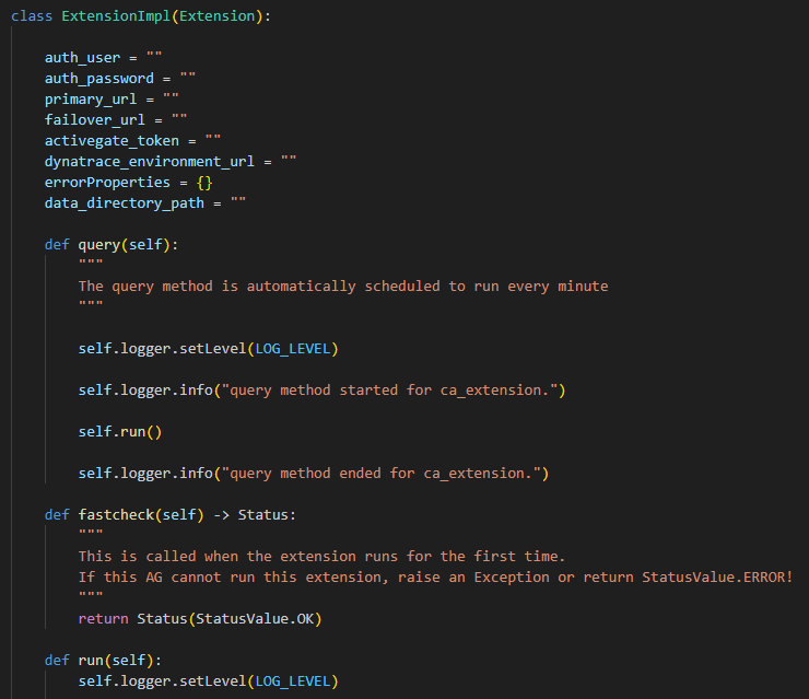

Here is a snippet of the extension code around fastcheck definition:
Hope you can give me a nudge in the right direction.

The task ID message is usually a result/symptom of the issue rather than the actual issue. It's often associated with that other message about the fastcheck.
"The code of the extension itself seems to work fine in lab environment, but the extension status seems a bit odd." - Does this mean it works running it in a 'dev' mode via the sdk or that it does work as a true extension in some cases? I'm also not sure what you mean by 'stopping' the data source? Do you mean disabling a configuration or something else?
Either way, it's likely related to the failing fastcheck - you should have a python.exe_fastcheck.log file in the datasources directory. For a simple fastcheck like that it's often related to some required module/dependency that's available locally when developing it not being available when it is built and running as an extension due to being missing from setup.py or some other initialization error somewhere in the code - doesn't have to be in the fastcheck section itself, if it can't be initialized at all the fastcheck will fail.

Ah, okay. There's an overlap in terminology - we also refer to the Dynatrace piece in the extension framework that runs the collection (e.g. Python WMI, SQL, etc...) a "data source."
The 'fastcheck' log and the corresponding 'task' log should only apply when the extension framework needs to schedule a monitoring task either due to the configuration being updated or an issue with the currently assigned ActiveGate becoming unavailable. Other than that, the fastcheck does not run so I can't see how taking the target of monitoring offline would (or could) be affected by that.
The details of how your extension handles that becoming offline will of course depend on how it was written but nothing I can think of would result in it trying to run a fastcheck unless you're making the original AG unavailable in your test and trigger fastchecks on other AGs. If you are seeing that and can reproduce it, I would suggest opening a support case so the owners of the framework can review it.
