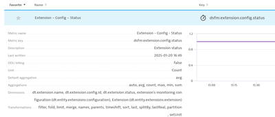

Hey @Manosirigosdyn7 , from the top of my head I have 2 ideas for this.
There's an Extension - Config - Status metric (dsfm:extension.config.status) you can probably use to get alerts on this. You can filter this metric by extension name and then split/filter by extension's monitoring configuration. Create a metric event based on this, and you can probably fulfill the requirements you described.

Hello Pedro,
thanks a lot! found also some other Status metrics also along with the one you said like  Extension - Endpoint - Statuses  or Extension - Status . They seem to do the job since we can use them for alerting as metric events! I'll let the team know!
