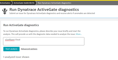

Hi @juangarcia23 ,
Check the network connectivity from the activegate to Confluent Cloud URL:
You can run and download activegate diagnostic of activegate selected:
then check the following logs dynatracesourceprometheus_fastcheck.log:
SupportArchive.zip\COLLECTOR\0x000000006b33b735\remotepluginmodule\log\extensions\datasources\com.dynatrace.extension.prometheus-kafka:
