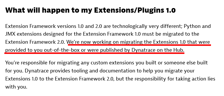

First of all, Dynatrace stated this in November:
https://www.dynatrace.com/news/blog/unmatched-scalability-and-security-of-dynatrace-extensions-now-a...
So, now we know that this is not true!
More, I'm pretty sure multiple clients we have and that use it are going to be quite unhappy! Having to write the yaml, is 1 or 2 orders of magnitude difficultier than it is today. And changing one query, we have to do it all over again??? Someone hasn't really thought how clients use Dynatrace, or at least, should be using it...

I remember this thread. At that time we were unaware that EF1 would be terminated. So, I was good with it. Now, it seems more and more clear to me that we have to have a plan B for EF1 termination!
I second what @ct_27  said at the time.
And regarding what Darek said, none of it will convince the several clients I have that use the extension...
