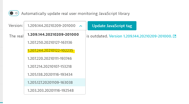

Hi @Paul P.
To JS tag version
From settings --> Preferences --> OneAgent updates
Mark the automatically update real user monitoring JavaScript library off, and you will be able to check on of the version mentioned above
for example 1.207.244 is present in our env
HTH
Yos

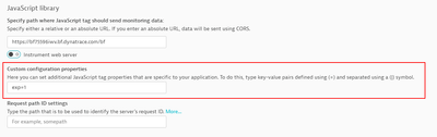

Hi
The JS version 1.211.169 was checked and it works correctly.
You need to add custom configuration property "exp=1" in JavaScript tag properties per application.
Best Regards
Tolik

Hi, to fix this, you must go to your Dynatrace application, click "...", then click Edit > Capturing > Advanced Setup, then scroll down and add "exp=1" here:
You can then re-download the agentless code snippet and add it to your FIORI plugin/application.
Hope it helps 🙂
